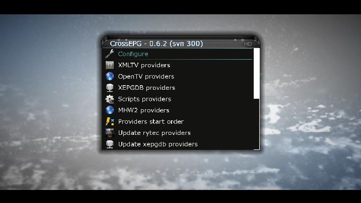

    How To Setup CrossEpg
    Menu > Setup > CrossEPG.

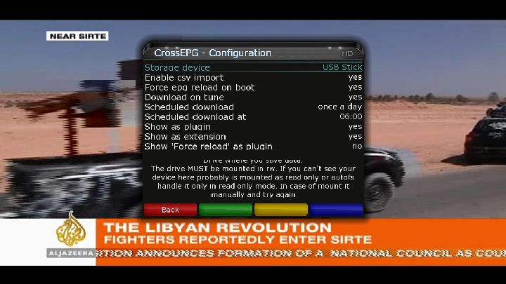

    Configure.
    Choose your storage device and a scheduled download for once a day. Press Red/Back.

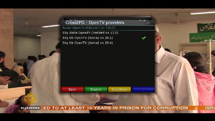

    I use OpenTV providers and find it more stable than BlackHole EPG.
    Choose $ky Uk OpenTV (Astra2 on 28.2). Press Green/Enable then Yellow/Download
