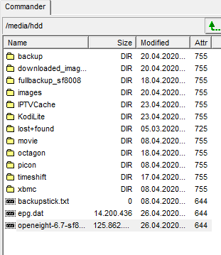

  • openatv 6.4 by it self,does not mean something, it must be after 18/4 and installed by usb recovery/flash image.
    if the above is ok, than... there are two ways. there is only limit, that all the images that you want to install, must have the new multiboot.
    in first message video, you can see the most of them.
    one more way, is to add your image in a usb stick , and "blue button/software manager/ flash online/ downloaded images" and select-install- to the partition that you want...
