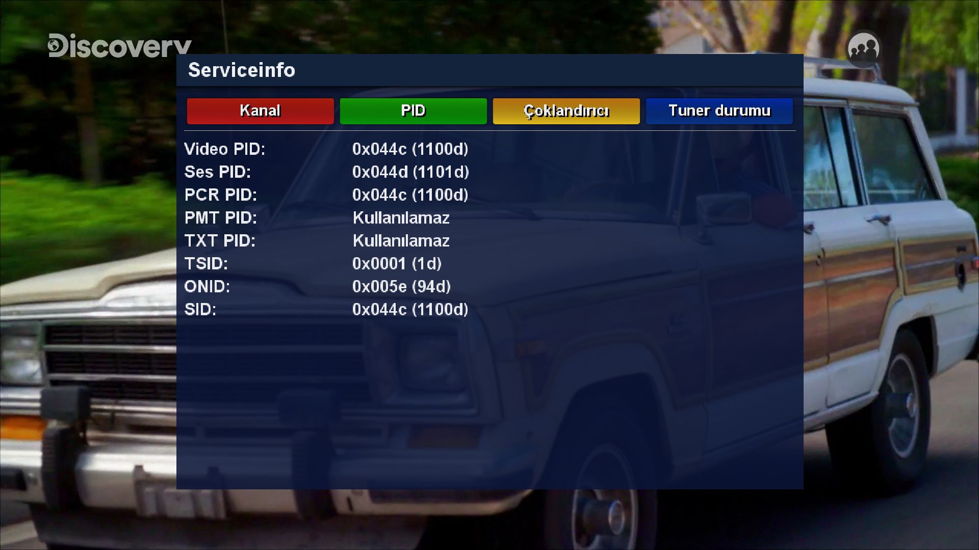

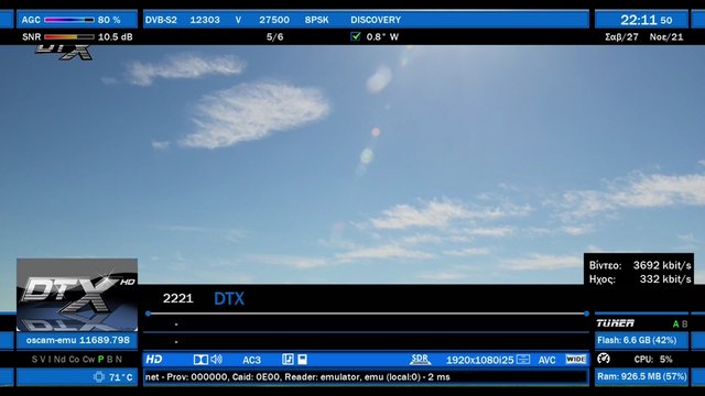

    same probleme on : Discovery Hungary (0.8°W ) sound ok but video no for almost 3 days ;
    is it a new encryption ...?
    tested with OSCam .
    Its not really a cam issue, it is missing the video pid from the stream, some non enigma2 boxes have no issues
    so you could edit the pid in your lamedb file to fix the video pid
    BUT then the key will need to be added to oscam like a constant CW......
    the problem with that is it will only decode one CW.
    So it is a 2 fold problem. For now all the channels can still be viewed between both 4.8e and 0.8w
    But as said it is the way enigma2 handles channels with pmt
