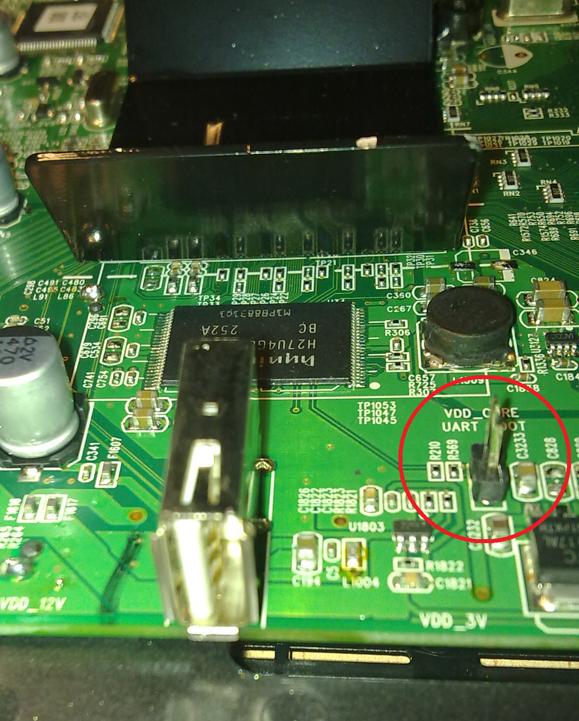

    4 Remove the plug of the AC adapter Prismcube Unscrew the case and put the jumper on jumper JP9 ( UART_BOOT )

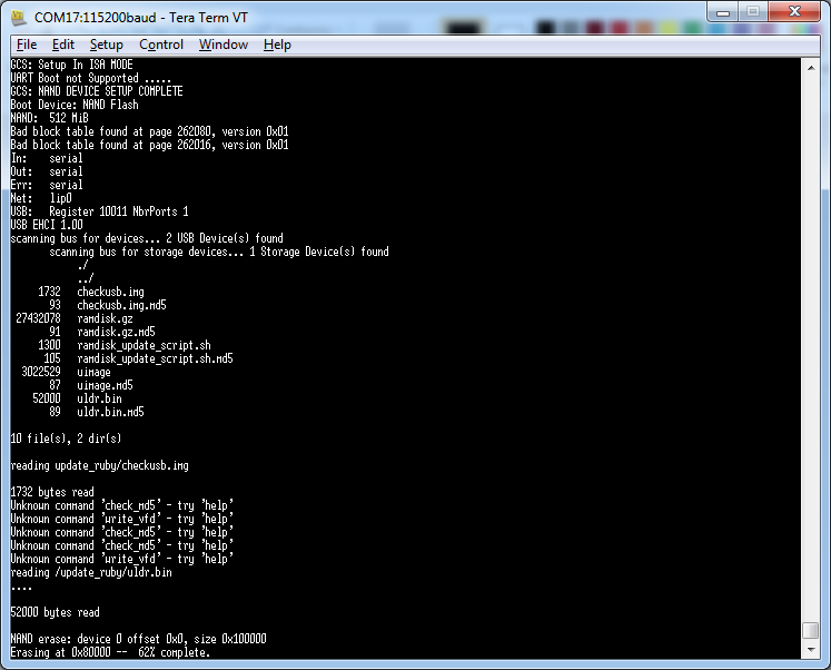

    7 Run Tera Term - will appear in the seriell highlight and select the serial port adapter
    8 The properties you select the port baudrate 115200
    9 Plug the power supply - if anything we set successfully , the terminal should show the letters CCC
    10th Selecting the bootloader to load the Tera Term File successively select File , Transfer, YMODEM, Send - here indicating locations of u- boot.bin file
    11th After the upload is complete software emergency will be displayed Remove USB

    Caution! It should be noted in the " scanning bus for storage devices ... " how many usb devices have been detected - should be two . If there is only one , then you should use
