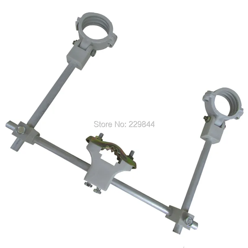

  • One must have more LNBs for more satellite positions that are more than 1 or 1,5 degree apart.
    Dishes can be single reflector (offset or prime focus) or dual reflector (T90, for instance).
    Then, you need switches (depending on your other equipment), good quality cables etc.
    Anyway, IIYF, m8 - for all sorts of combinations... :)
    Free-Shipping-Multi-Feed-LNB-Bracket-Holder-For-Satellite-Dish-Or-Antenna-Hold-Up-To-3.jpg

  • As what's posted above, you'd need a dual LNB holder, but I think due to the size of the unicable LNB's we stock it will be hard to get both 13 & 19 degs. I think our LNB's will be too wide. The two satellites are only 3 degrees apart so you'll need some narrow unicable LNB's.

    My intention is to mount the stirrup with 3 lnb pointed to 13, 16, 19.2.
    The techician, said to me that, however, isn't possible to see from 2 sateliites at the same time. Is it true?
    What configuration do you recommend, to mount 3 lnb.
    • What kind of lnb do I need? The techician said to me that one could be standard, but the others two needs to be "PIN" translato from italian, he said that these kind do not allow interference with the only classic lnb.
    • what do I need to use/exploit properly and correctly the 16 demodulators made available by the two two dvb-s2X tuners, so theoretically have the possibility to see 16 channels simultaneously
    • As, above. Does the vision of a satellite affect another's?
    • What kind of switch do I need? If I need it?
