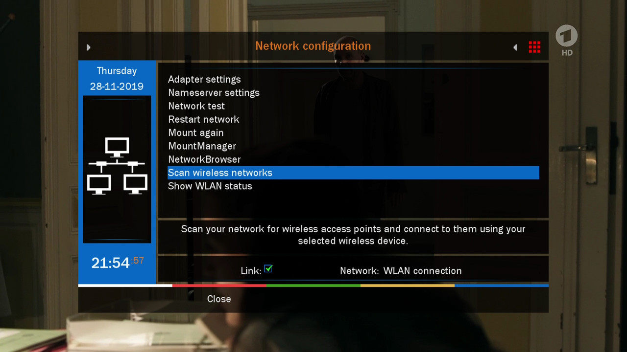

  • first of all, your receiver has the wifi chip?
    if yes and you already have your wifi activated from the receiver, than go to "scan wireless network" and find /select your wifi spot.
    than return to the "adapter settings" and in the "encryption" select the security system of your router (wep /wpa etc...)
    and below this, you can add your wifi key
