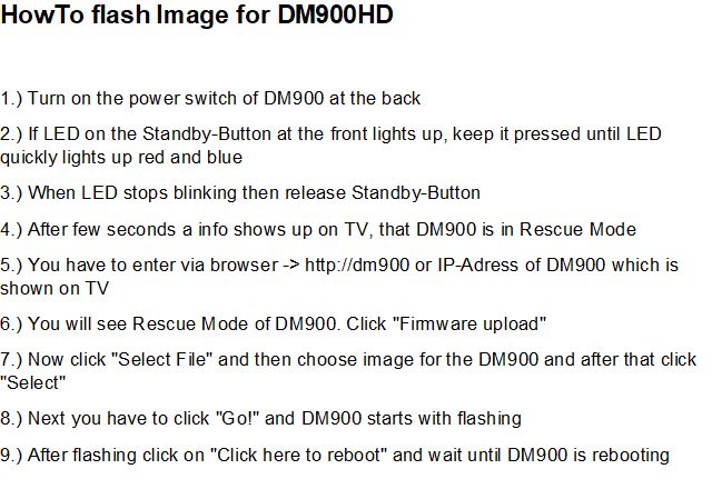

    I have a dm900, after been gone for 2 weeks i turned on the receiver but the oled screen was totally white
    I did a reboot and it won't boot ... so i did rescue mode and it really took a while to show an ip adress.
    When i try to flash a new image it gives errors like '' error 5 cannot create partition table etc.. etc.. ''

  • Hello again , i tryed dreamUP the com3 port becomes available with mini usb and lan connect but i don't get any ip adress anymore....
    I will try tomorrow with mini usb only connected any tips..? i did use dreamUP with the dm500 long time ago through serial connection.....
    Any help will be really be appreciated

    Not working with the commands trough putty ssh, error 5 i cannot flash it again ... i think the internal flash has died or something dammit...
    follow the link register on the Domica forum, if you don't know Russian well, use an online translator ...here everything is described in detail how to restore dreambox900-920, good luck!!!
    http://www.domica.biz/index.php?topic=15938.0
    if you can't find a solution there either then look for information - Through the service port, you can restore using the TFTP server running on the computer.
