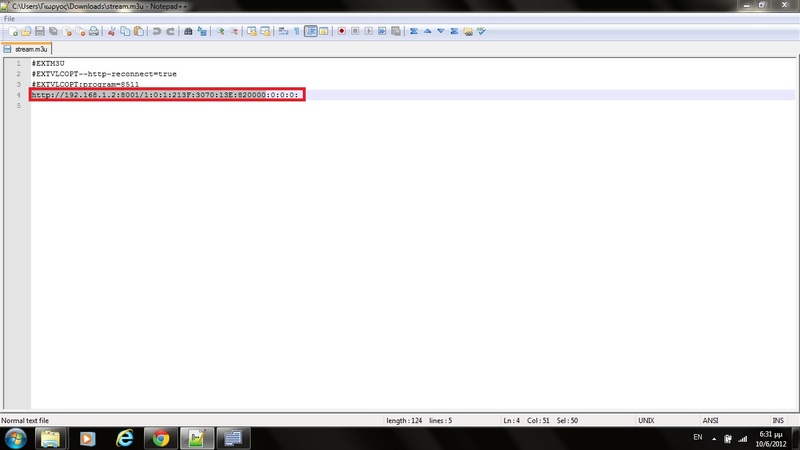

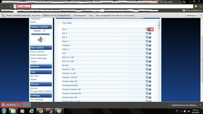

    In our pc on internet explorer (in address place) we write ip from lan reciever and when we have webinterface on screen right click on stream (small tv screen icon) our browser download one stream file
    now with Notepad++ program we open this file (right click on downloaded file /open with notepad) we copy ip and port

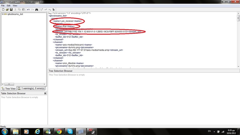

    now with DCC program we conect with wifi receiver and we are going to usr/lib/engma2/python/plugins/extensions
    and open nstreamplayer folder we need file with name nstreamplayer.xml we take one copy from this xml to our pc and we open it with xml Marker program
    and now we edit it like that :
    in stream url we paste ip and port from Notepad++ copy and in channel name we write our channel from lan receiver
    now you can watch all channels from this transponder but you can change channel from lan receiver
