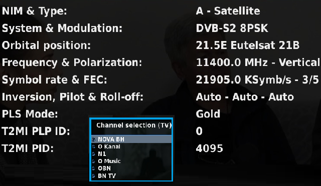

  • Hi everyone, I can't receive all the channels available on this frequency. 11400 V 21905 3/5 21.6°E.
    Of the 17 channels, I can only see 5. I tried entering ID 1 to 8 in satellites.xml. When scanning, it searches for all the channels, but when I watch, it always shows the same ones.
    Can anyone with more experience memorize all the channels ?

  • If you change the PID 2 data another channel will come out and so on up to PID 8
    <transponder frequency="11400000" symbol_rate="21905000" polarization="1" fec_inner="7" system="1" modulation="2" t2mi_plp_id="0" t2mi_pid="4095" />
    <transponder frequency="11400000" symbol_rate="21905000" polarization="1" fec_inner="7" system="1" modulation="2" t2mi_plp_id="1" t2mi_pid="4095" />
    <transponder frequency="11400000" symbol_rate="21905000" polarization="1" fec_inner="7" system="1" modulation="2" t2mi_plp_id="2" t2mi_pid="4095" />
    <transponder frequency="11400000" symbol_rate="21905000" polarization="1" fec_inner="7" system="1" modulation="2" t2mi_plp_id="3" t2mi_pid="4095" />
    <transponder frequency="11400000" symbol_rate="21905000" polarization="1" fec_inner="7" system="1" modulation="2" t2mi_plp_id="4" t2mi_pid="4095" />

  • 11400 V 21905 3/5 21.6°E.
    DefineOS image no problem 15 channel
    t2mi_plp_id="0" t2mi_pid="4095 ( O Kanal , NOVA BH , BN TV , O Music , OBN , N1 )
    t2mi_plp_id="1" t2mi_pid="4095 ( Pro tv )
    t2mi_plp_id="2" t2mi_pid="4095 ( Herceg TV , RTVIS )
    t2mi_plp_id="3" t2mi_pid="4095 ( CH4009 )
    t2mi_plp_id="4" t2mi_pid="4095 ( RTV USK )
    t2mi_plp_id="5" t2mi_pid="4095 ( RTV TK , NTV Arena )
    t2mi_plp_id="6" t2mi_pid="4095 ( RTV BPK )
    t2mi_plp_id="7" t2mi_pid="4095 ( TVSA )
