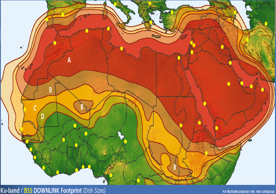

  • compiled here are peoples reports of signals received and dish size used ! note the 60cm dis in north africa - lol - 310cm in central france and a 140cm in south UK . i previously used a 1.5m and that had similar results . However i aint finished YET - if i get it screen shots will be posted !
