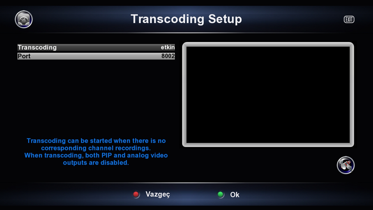

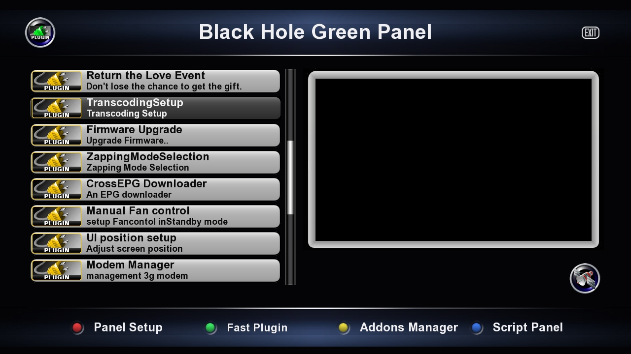

    Step 2 On solo2 Go to Menu > extension > Transcoding Setup
    Step 3 Activated transcoding there

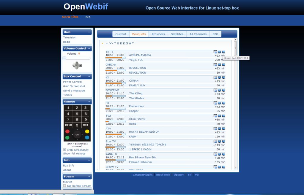

    On top left hand side click tv then sellect bouquet Choose the 2nd tv icon then selected channel will start play in a few seconds its recommend 2 satellite cable on your solo2 if you have only 1 cable running from your dish then you can only watch what channel showing on your solo2
    Some picture from android tablet
    Picture From pc vlc player
    Via 1Mbit Upload you can easily watch tv from your solo2 anywhere in the world long as you are connect to the internet
