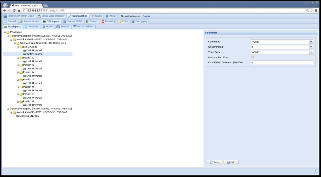

    Click on "Configuration" then click on "DVB input"
    Quote
    click on "Availink AVL6211+AV2011 DVB-S/S2 : DVB-S #0"
    Quote
    by SatConfig: clink on the pull down menu and choose "Advanced (Non-Universal LNBs, Rotors, etc.)"
    Quote
    check the box by "Enable" then click on [Save]

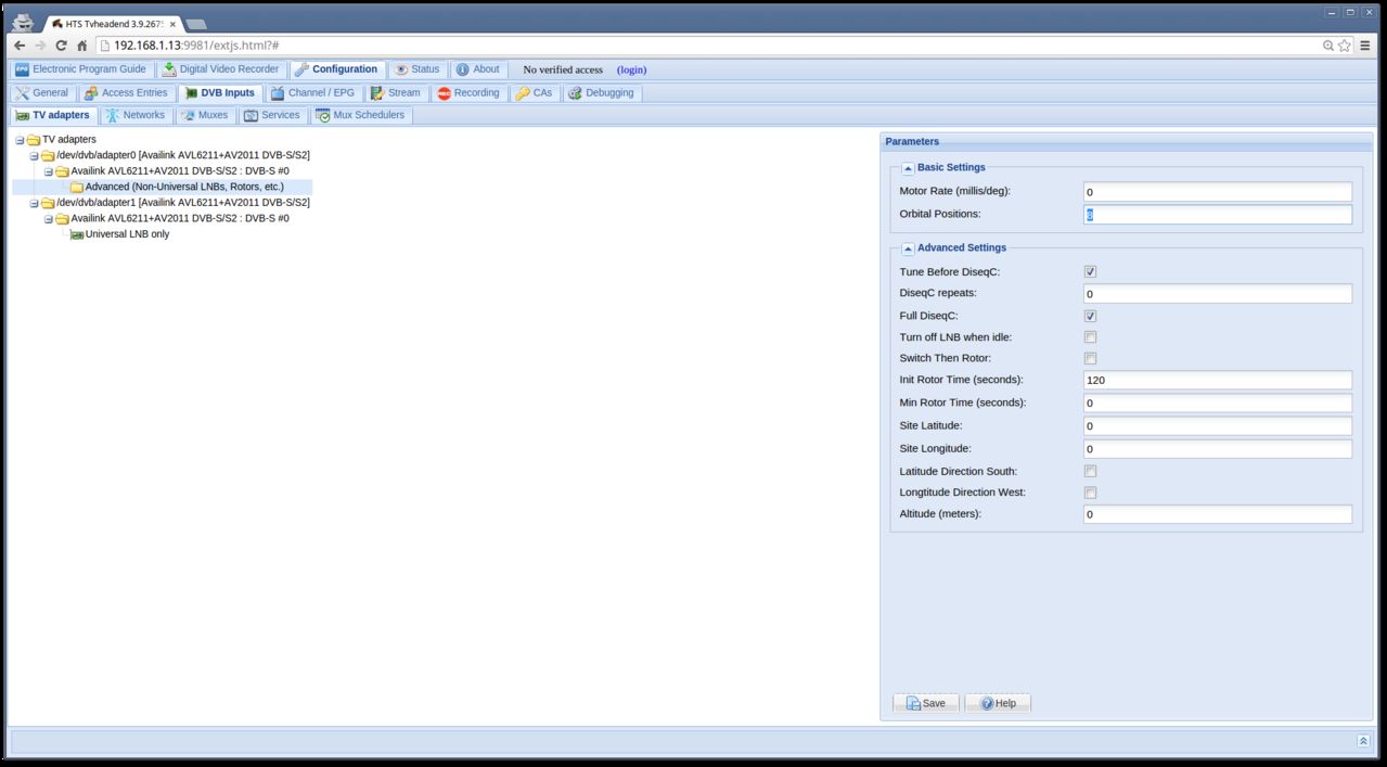

    [step 05]
    Quote
    Quote
    By Orbital Positions: replace the 0 into 8 then click on [Save]

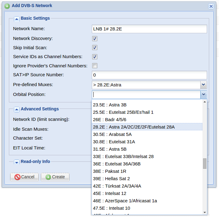

    [step 06]
    LNB 1 = 28.2E
    LNB 2 = 23.5E
    LNB 3 = 19.2E
    LNB 4 = 16.0E
    LNB 5 = 13.0E
    LNB 6 = 7.0E
    LNB 7 = 4.8E
    LNB 8 = 0.8 W

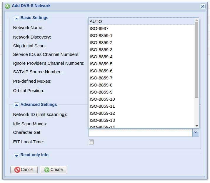

    Quote

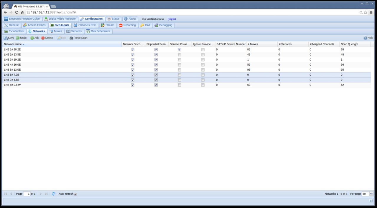

    Click on Networks
    Quote
    Click on "Add"
    Quote
    i have have a wetek with 2 satellite tuners so i need to click on "dvb-s Network"
    Quote
    Click on "Create"
    Quote

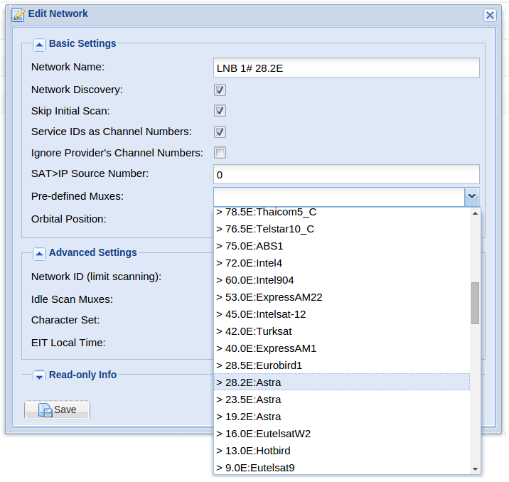

    after we do this by all 8 sat we get this to see
    Quote
    the sats on the blue lines, tvheadend have not there "Pre-defined Muxes:" for
    you must add your self

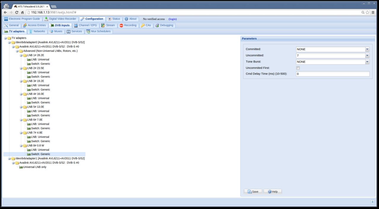

    [step 07]
    Quote
    This are the setings for this lnb
    click then on [Save]
    Quote
    Uncommitted:0 is lnb1. Uncommitted:7 is lnb8
    Quote
    repeate this by every lnb
    Quote
    this you get if you have do all lnb
