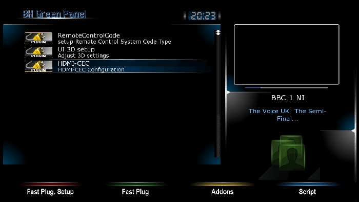

    In BH ,press GREEN for green panel then go down along the plugins ,prob the last one and you wil see this:

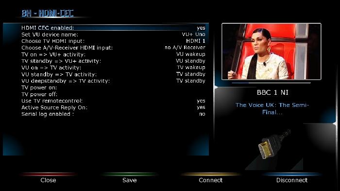

    then you have the option yes/no, if you leave yes ,then you get this :
    Remember to save your settings ,,,
