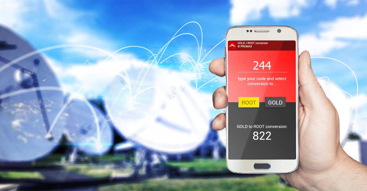

    WHAT IS THE PLS CODE?
    Physical Layer Scrambling or PLS is used in DVB-S2 as a form of low level encryption. A receiver will be unable to operate on a channel unless it is provided with the correct PLS code for that channel which can be Gold or Root.
    WHAT ARE THE GOLD AND ROOT CODES?
    The PLS code can be Gold or Root. In the world of mathematics they are two different types of binary sequence which have been widely used in telecommunications due to their particular properties. For us earthlings they are simply two ways to enter a PLS.
