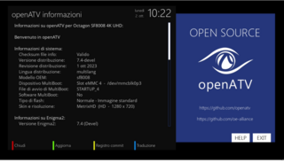

I also had a loop when starting E2 on SF8008, it stopped at 48% and the update command in telnet did not work.
Download the log file from /home/root/logs and check which files contain errors.
I had it like this
Code17:58:18.2952 File "/usr/lib/enigma2/python/Components/PluginComponent.py", line 60, in readPluginList 17:58:18.2953 File "/usr/lib/enigma2/python/Tools/Import.py", line 2, in my_import 17:58:18.2956 File "/usr/lib/enigma2/python/Components/Language.py", line 34, in addCallback 17:58:18.9837 File "/usr/lib/enigma2/python/StartEnigma.py", line 943, in <module> runScreenTest() # Start running the first screen. 17:58:18.9839 File "/usr/lib/enigma2/python/Tools/Import.py", line 2, in my_importI downloaded everything from https://github.com/openatv/enigma2
I deleted the pyc files of the files that were causing errors and uploaded the py files downloaded from GH to the specified locations
I don't remember anymore, but I think I also changed the skin.py file ->https://github.com/openatv/eni…f22fbc42e3f2452aeb8af1ac9
the init 6 command and the box was up, fortunately
Then in the GUI from the update menu and everything went back to normal.
Maybe it will help someone. It helped me.
