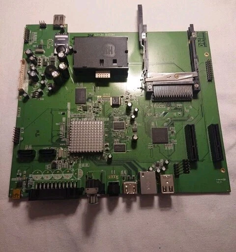

  • Can you check the Capacitors on the motherboard ? I had one of my DM7020HD who had problems, more and more... and there were 3 big capacitors with a hill on top... near to the black smartcard readers.
    TS
