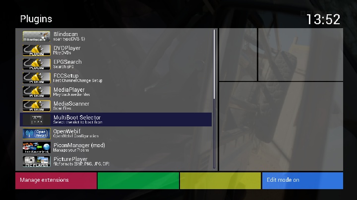

  • Date: Thursday, 01 January 1970 - 01:08:08
    Architecture: armv7l
    OS: Linux
    Kernel: 4.1.20-1.9
    Kernel build: #1 SMP Tue Jul 15 22:22:54 CEST 2025
    vuuno4kse login: root
    Vu+ Support Forum
    Home of VTi Image
    www.vuplus-support.org
    home of
    | $$ | $$|__ $$__/|__/
    \_/ |__/ |__/
    Welcome on your Vu+ !
    root@vuuno4kse:~# opkg install --force-reinstall /tmp/*.ipk
    Installing enigma2-plugin-extensions-multibootselector (1.12-pre) on root.
    Configuring enigma2-plugin-extensions-multibootselector.
    root@vuuno4kse:~#
    - Install OK !!!
    - GUI restart
    - Menu-Plugins ... screenshot !
    Image is build as being "single" and destryos the multiboot structure !
    To repair ...
    - use a FTP client to access the image
    - goto /boot
    - edit the STARTUP file
    - change the linuxfsx to linuxfs4
    - save the changes
    - reboot
