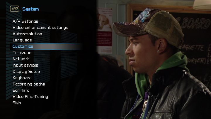

  • please can somebody help me please have formated my harddrive and mount it media/hdd then down load epg data which works great but when i record anything it changes the channel to recorded but they is nothing there later when i go to watch it ?
    Press menu/setup/system,
    If you cannot see the recording paths there then change the setup mode to expert as in the pictures below.

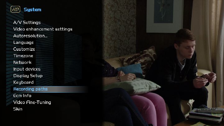

    Save & reboot the box, once restarted recording paths will be visible under menu/setup/system as below.
    These settings are for recording on network mount, adjust yours to your hdd path.
