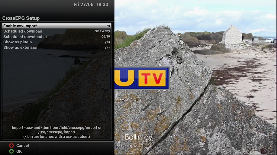

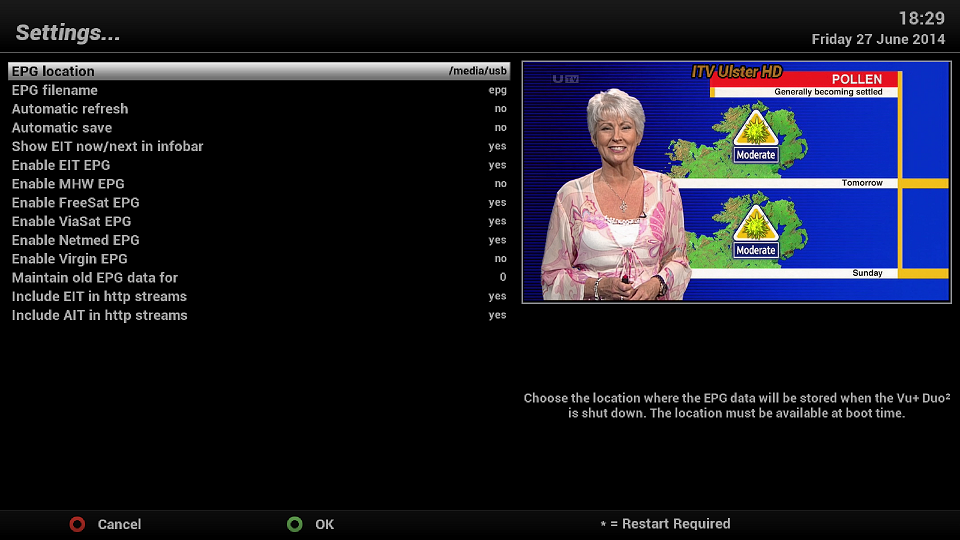

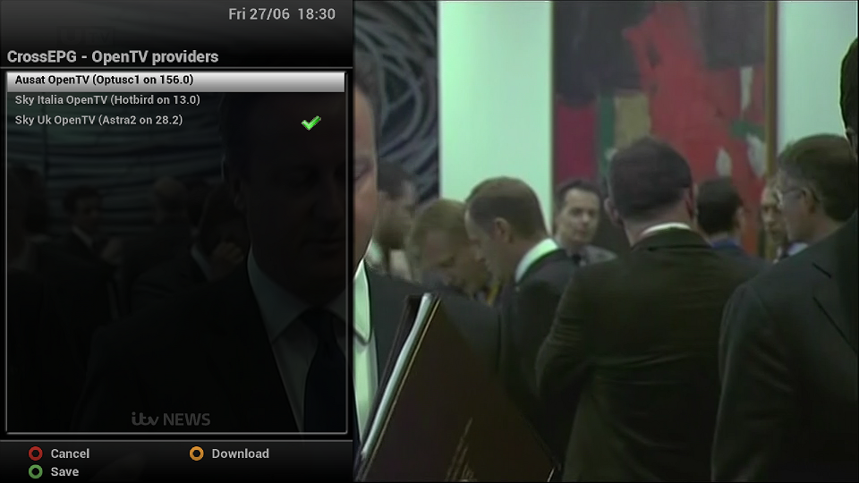

  • Ok here is the way my own settings are:
    menu/setup/system/epg/settings
    menu/setup/system/epg/crossepg/configure
    menu/setup/system/epg/crossepg/opentv providers
  • Mine is exactly like you have setup yours, the only difference was, Virgin, Yes, now No. Tried the download again, nope. I have had permission to try Blackole again, ("What another Image??") said the wife. Now you can see the predicament I'm in. Have to go through all my bouquets and go through each channel again so the bouquets will populate. Is that something to do with the EPG? Looks like your pics is something else I have to get my head around. But first things first. Going to install BlackHole 2.1.0

  • mckee25,
    Yes, yes, yes, yes, yes! I had my configuration of ABM all wrong. Set it up for *** and low and behold 1 ABM. Menu, epg, double checked against your configs, went to download and Blimey it works. Downloaded over 900 channels, can't remember the exact figure, 928?? BTW, one VU+ Solo2 NOT FOR SALE! I have tried Software update and it tells me Nothing to Upgrade. Might try the Telnet method. I got from Marysia, my wife, I knew you would do it. "You are like a Terrier with a bone have to do it, keep eating". She's lovely.
