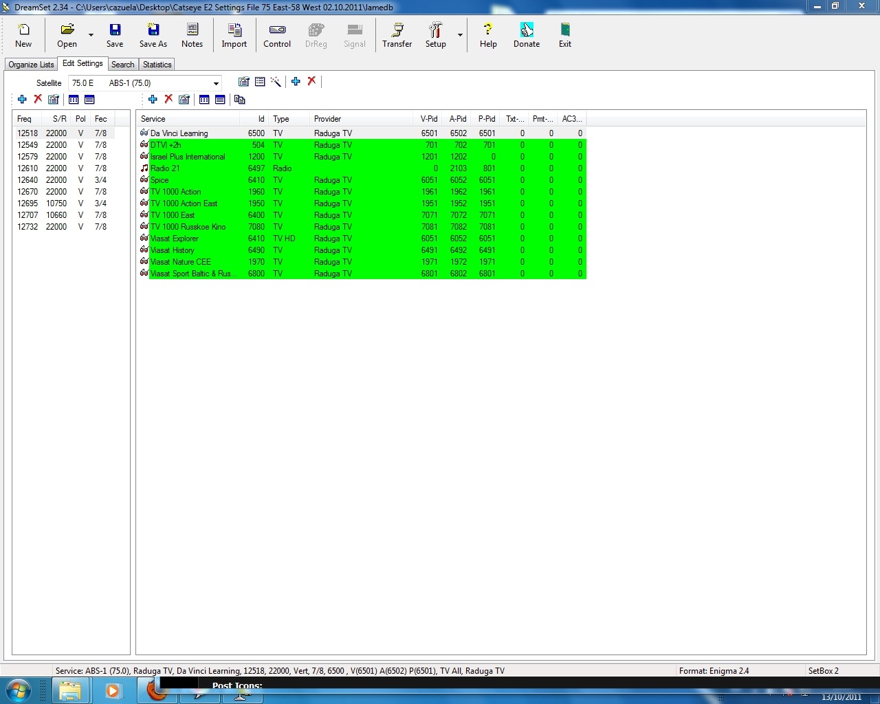

  • Thanks cazuela, yes I have updated the current channel list, it has the correct v-pid and a-pid as sent by the provider, unless the correct v-pid is hidden from view. Is there a way to find the running list of pid's?

    cazuela; you mentined a pid change, how can I do that? ie. change the video pid, where do I look and which file to use, can you please advise? Also is there a way to extract the log files from the box?

  • Not having an openbox I don´t know the configs but I imagine you have installed a recent channel setting? this is sometimes better than the automatic scan as the automatic scan will only scan the frequencies,pids,etc that have been preprogrammed in the box.

  • Thanks for the prompt reply, the chanels were loaded off a published list and since it didnt work did a blind scan and both the lists are the same. Have tried with 3 different piers result is the same and I am not using softcam or other config files are used than the clines in cccam.cfg.
    can you kindly explain the pid change method? how do I do that?
  • No luck cazuela, dreamset does not talk to the box. there is hardly any software that can see what is going on on the box. so that option is out. is there any cccam/mgcam/newcam config file that can replace pids?

  • Thanks mate, I believe that you pointed me in the right direction to replace the channel, doing that with replace.list for vpid did not work, however it might work if I can find the correct PMT pids and use setedit as I managed to get it working. So now to look for the PMT pids for nss6. any tips will be appreciated.
  • Yes and thanks mate, same here have not found any though found this in a forum where the pids were changed from 6100 to 6103. It is on a dreambox I guess, when I tried this with the replace.list nothing happens.
