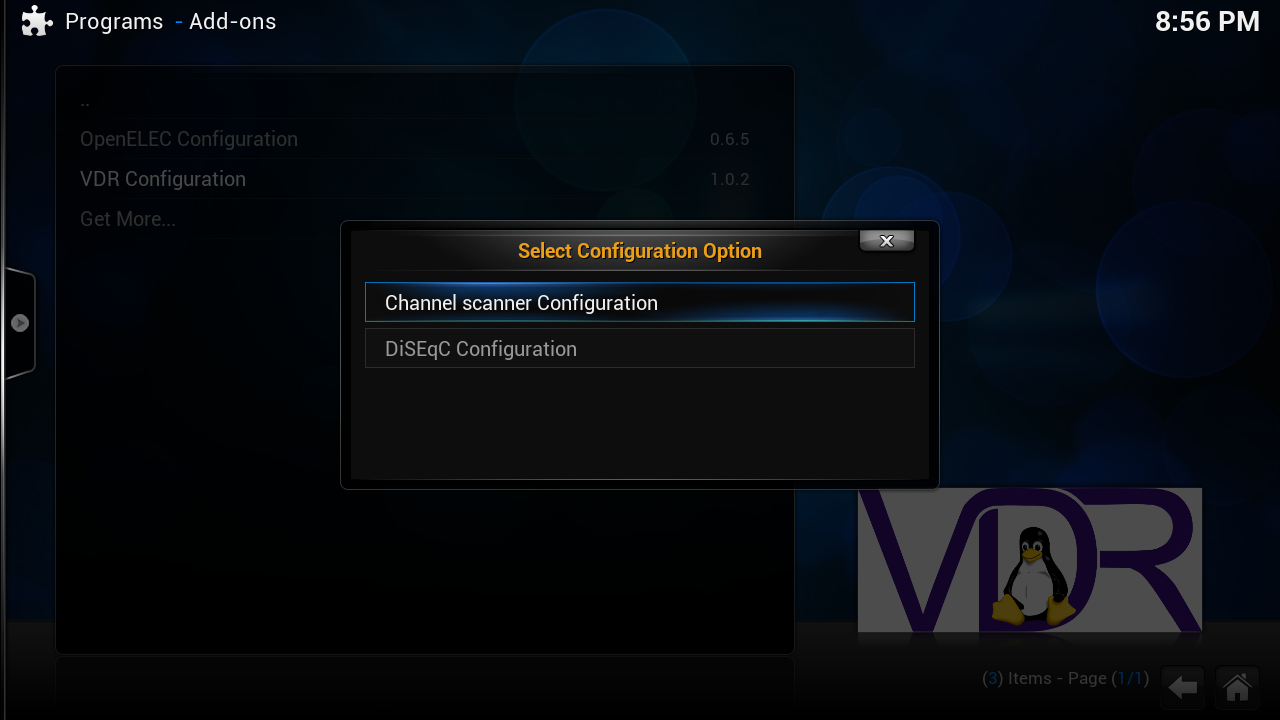

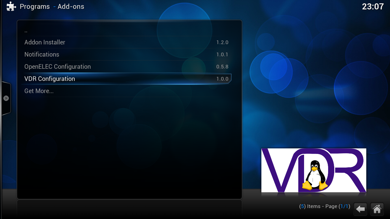

    WeTek is proud to announce Scanning Menu for users of OpenELEC which are using VDR to watch DVB on their WeTek Play.
    How to install and use this Add-on?
    1. Install VDR
    2. Enable restfulapi in the vdr-addon (configuration) - set ip to 127.0.0.1
    3. Enable vdr-vnsi in Live TV
    4. Install from .zip this Add-on
    5. Reboot WeTek Play
    6. After WeTek Play is rebooted, add-on will be available under Main Menu -> Programs

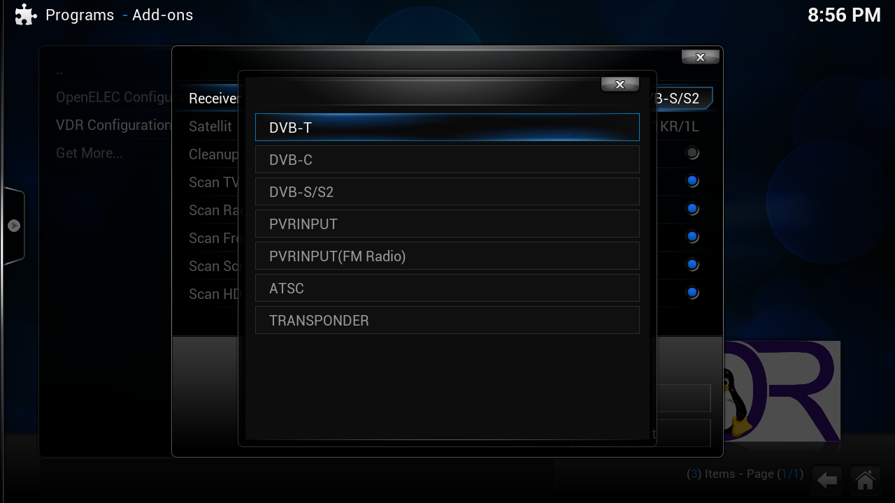

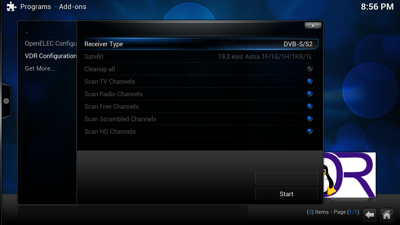

    From this Add-on you can easily scan and configure your DVB tuner settings without headache.
    vdr-addon -> Configure -> Plugins -> Enable plugin: Restfulapi
    Scanning menu is available as VDR Configuration under Programs on main menu
    VDR DVB Scanning Menu make life easy :)
  • nice 1 thing most people dont know the names from the satellite ike astra2 = 28.2E in the menu are only the names no 28.2E it easy addon i think if the 28.2E and so i in the list then it is very easy :)
    btw it works on kodi 15.0b1 too

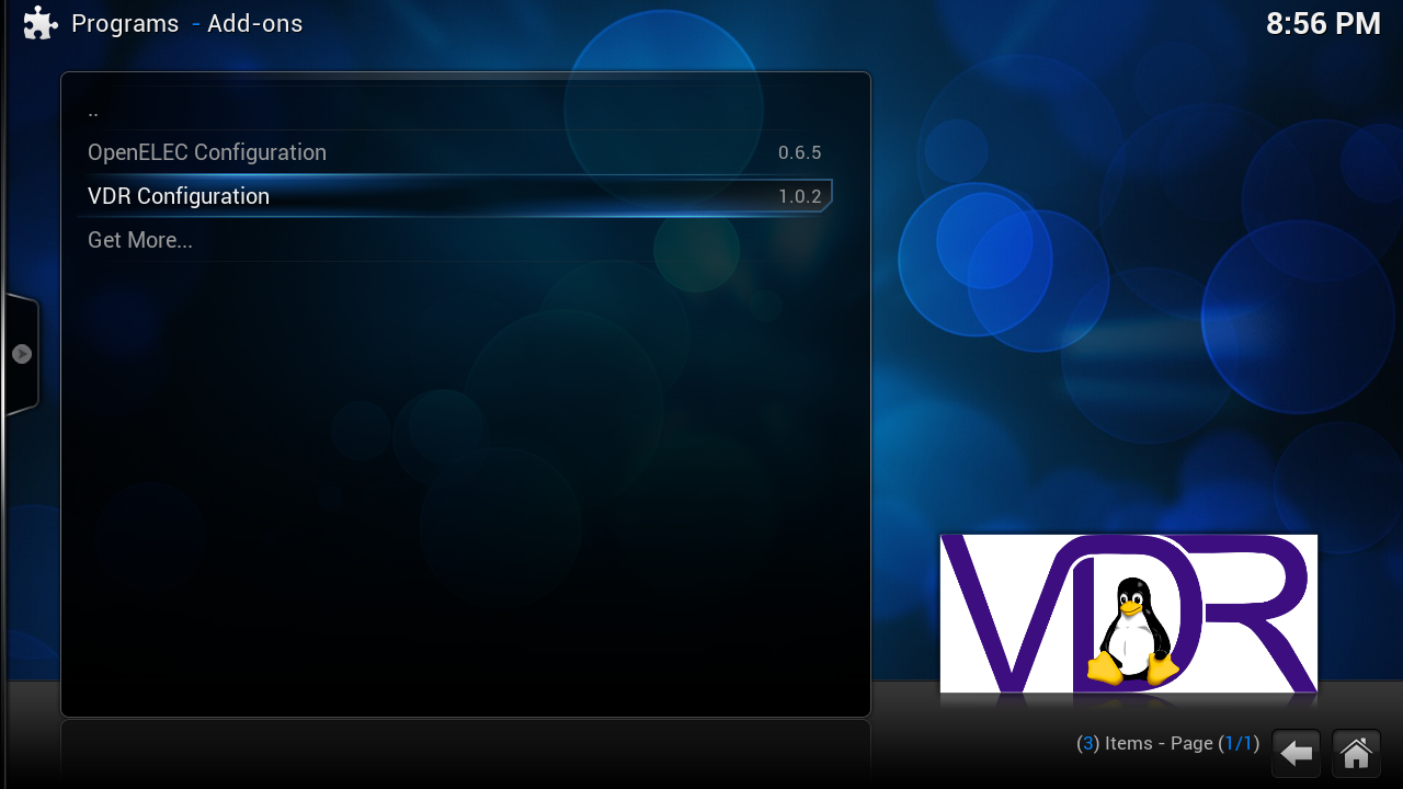

  • hello mate
    running openelec 5.0.8
    installed VDR
    enabled live tv
    enabled VDR-VNSI
    enabled restfulapi
    set ip 127.0.0.1
    under program there's no addons listed.
    so i can't get to VDR Configuration
    regards: canthackit

    OK
    could this be the problem?
    i havn't done this
    does his mean load the script.config.vdr.zip onto the wetek?
    if it does how do i do this, there don't seem to be a ftp program so how do i do it please.
    in the meantime i shall be trying to do this lol
    regards:canthackit
  • you need to install add-on from zip, put it on .usb and go to section to install from .zip, of course, if you dont install it you cant see it under Programs

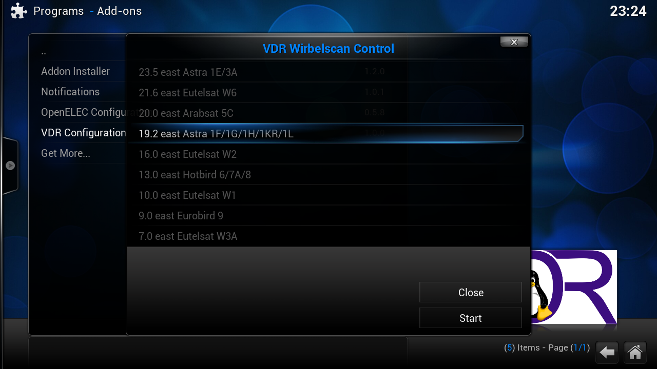

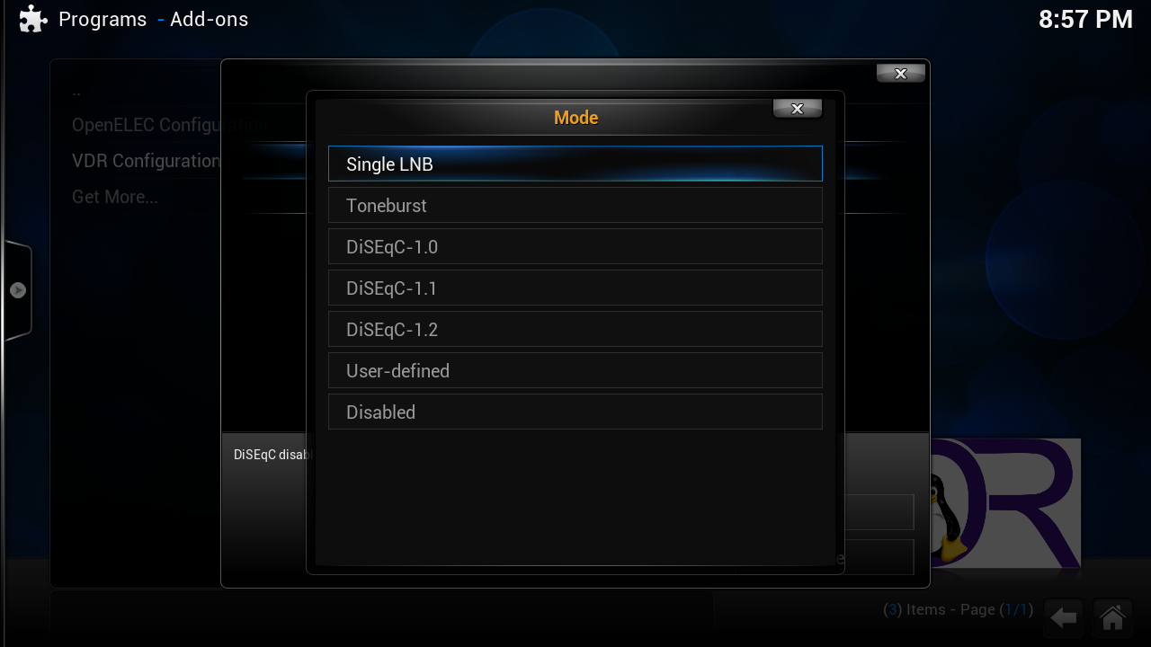

  • for people who wil try this and you must config diseqc config if you use a standard lnb
    choose then in the config for 9750/10750mhz ku band LNBF (Linear)
    if you look for asta2 28.2 East, you mus look for Eutelsat 28A
    save the config and reboot the wetek so you are sure the vdr read again the diseqc.conf
    i wil make later a tutorial about this :)
