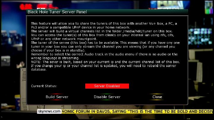

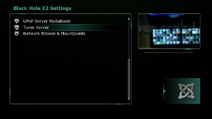

  • hi all this is how i got tuner server working on my vu ultimo

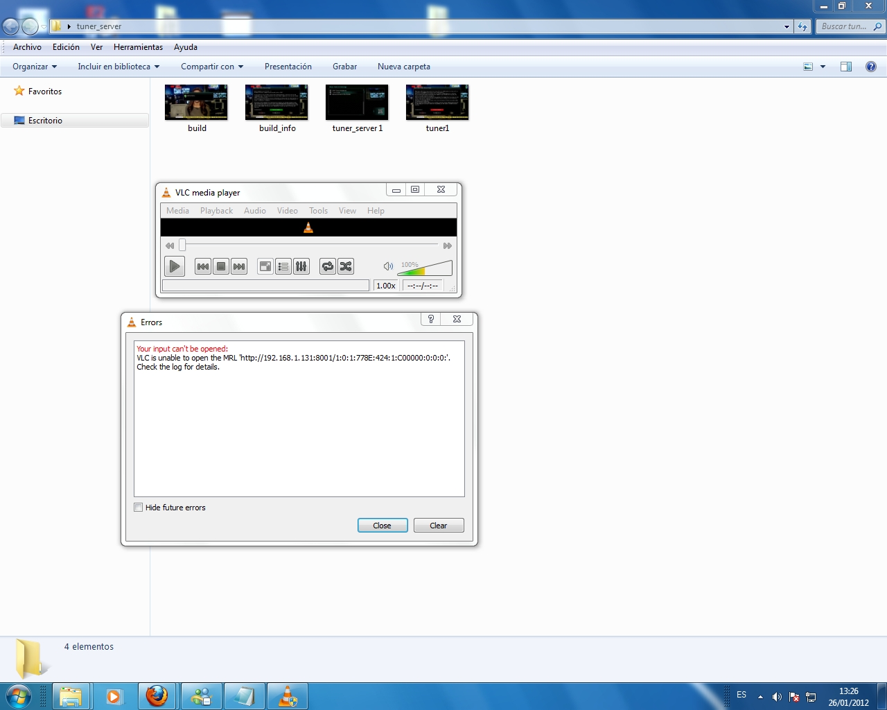

    first i went to the blackhole e2 settings by pushing blue x2 and enabled tuner server using lan ? then i used filezilla and went to my hardrive and copyed the tuner folder to my pc then downloaded vcl player and used that to open the tuner files and it played ok on sd channels but not hd ? if anybody has a better way of doing this please post it thanks ??

  • This was setup using LAN from vu UNO to a pc
    If the tuner server is on one channel (working)then the client cannot access another outside transponder range.
    As far as channel selection ,seems SD is only possible,not HD..
    ¿ anyone else tested this ??
    I found that streaming directly from UNO to pc(vlc) to any other player(vlc) is more comfortable, again it is limited to viewing the one channel being streamed,but at least it this way it is accessible not only from internal network but also external network.

  • master G, what a lovely (and timely!) tutorial. This got it all working perfectly in less than 5 minutes so thank you for that.
    This is the perfect stop-gap for me because since buying my Ultimo, the Duo has been sat sulking and unused in a corner waiting for me to sort out additional feeds into the bedroom. I have just taken it and plugged it in up there and performance on all channels seems great so far (via all-wired ethernet).
    As Sandman points out, it is perhaps not overly user friendly, but it certainly is a lot better than nothing.
