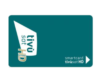

  • Hello,
    NO, it is not possible for the GREEN card to be read on a CAM, only the black card with its CAM4k as shown in the image.
    I have personally tested this on my VU+ devices.
    The GREEN card only works in its official SKY receiver.
    If you are referring to this GREEN card ====> NO !!

  • Hello,
    Ok, so, if I understand correctly, the CI+ module itself is compatible with the VU+ Solo2.
    Do I need a specific version of OSCam for this to work properly?
    Thank you very much for your reply, it really helps me.

  • Normally, OSCAM is used if you do NOT use CAM, but if you have a GREEN card, it is also impossible.
    Currently, OSCAM for the Tivusat card is only GOLD or the old orange or light blue ones.

    The Green and Black card, if I remember well, are 1856 ID (not 183d SD or 183e HD/Gold-SilverUHD), so the black Cam working with the black card, could potentially be compatible with the Green 1856 card. Someone tested ?
    TS
  • I haven't tried it myself because I don't have it. But logically, it should work.
    That's why I don't write about things I haven't tested.
    VU+Ultimo4K- VU+Uno4KSE- VU+Solo4K-VU+Zero4K- VU+Solo2 -Octagon 8008- Pulse4K Mini-
  • I confirm, it works.
    Vu+ solo2 | Vu+ zero | OpenPLi | LNB Monoblock Twin INVERTO (6°)
