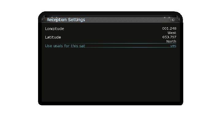

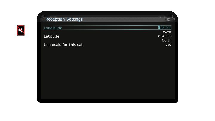

    First of all you need to have a recent satellites.xml file or upload a latest Enigma2 channel list, look on the forum for this theres plenty of info.
    Set Tuner A as below, only changing the usuals position to your own, use dishpointer tab on the top of the forum to get your position;
    Press OK

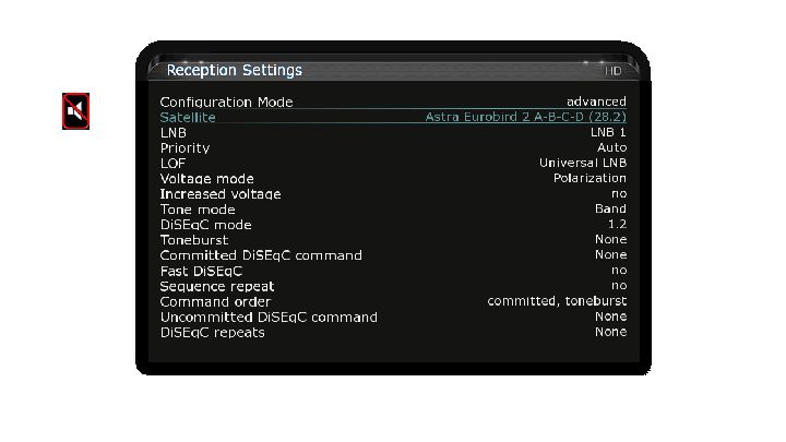

    Press OK again, now enter the tuner and select another satellite you want, say 19.2E.
    All you need to do is change DISEqC mode to 1.2, all the other settings like usals are already there. Press ok save, now zap back to the tuner again.
    Repeat the same process for every satellite you want.

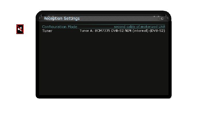

    For Tuner B set as below;
  • I´m having a very similar problem with UNO ,,except mine is stuck on 19º.
    I have it configured in advanced..
    obviously something in the settings which isn´t right ¿¿??
    the DM turns it no probs....
    Any help much appreciated
