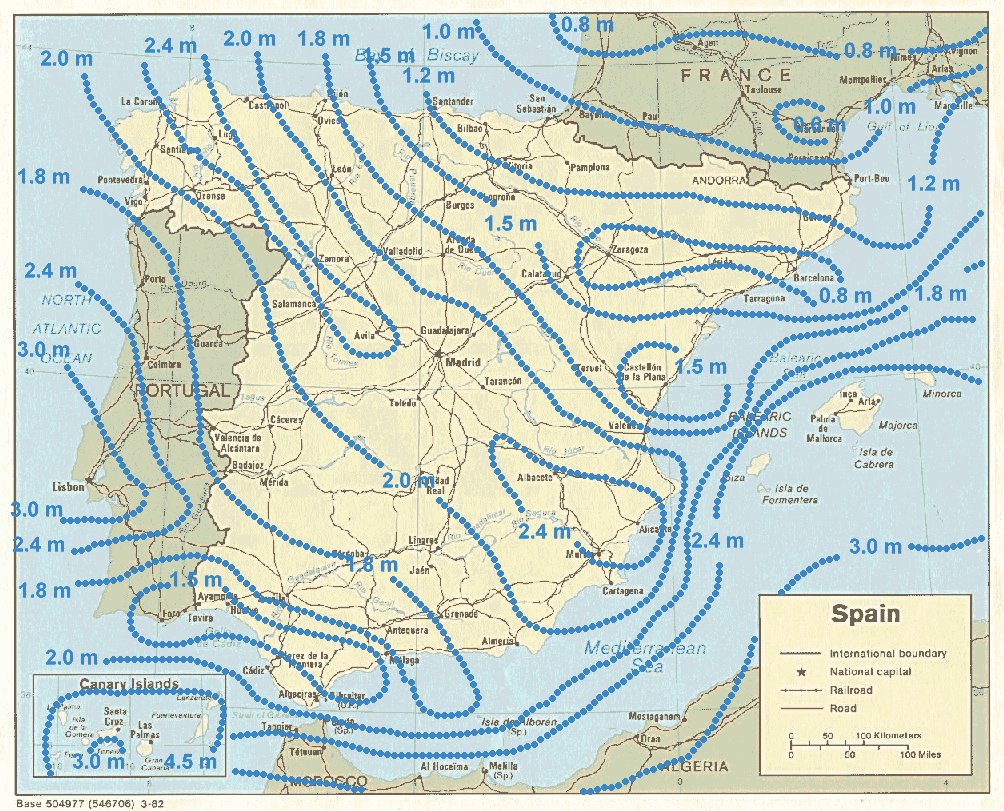

  • The red bands are the dips in signal (lowest signal), outside these are lighter dips where the signal can vary.
    Example dated : 28.03.2014
    frequency : 10773H
    Barcelona cannot capture at 1.85cms ( real )
    Madrid captures at 93x 96cms ( real )
    My own experience with 120cms motorised is signal varies from 23% daylight -43% night time depending on weather on the coast of Northern Spain.

    Your sibling is going to struggle big time on the costa for channels on astra 2e macsporran...spot beams active now and thats why they are loosing channels in the coast of the sun:)..also....looking at the footprint i would even dought that a 2.4 andrews would help so i would suggest looking at alternatives on 10 east/and or 27.5 west.
