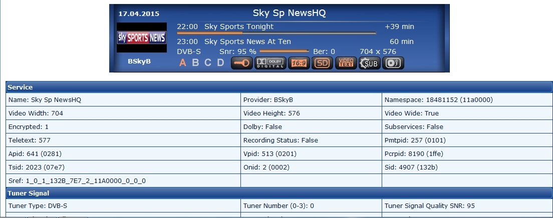

    motorised 1mt dish 8way lnb
    28 east signal problem
    watching majority of channels, except ss channels these are showing 98%/99% snr but not locked
    in positioner set up.
    on screen no data on transponder timeout
    any ideas what this problem might be
    Can't be the dish lnb or cable or connections as all other sats are ok
    any help appreciated

    Thanks Cazuela just tried it, still the same problem

  • It's the settings that are causing the problem,
    I have just manually scanned 28.2 and everything now working perfect.
    I thought from the outset that the channel lists was the problem, but after trying catseye and vhannibal I did not expect
    both channel lists to have the same faults.
    Thanks for all your help
