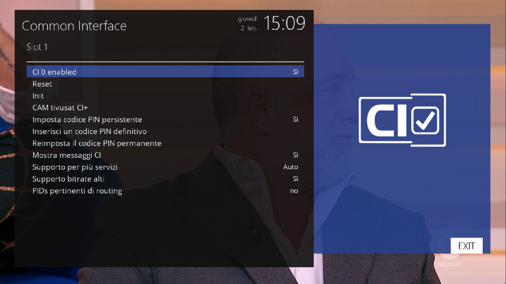

  • Hi,
    I've been dealing with this issue for sometime and now trying different solutions and would appreciated feedback from CI+ pros.
    So, I have two modules (Kablio Panaccess & M7 Cam 803 Nagra) using them on Zgemma H9 Twin (1st version) with Oatv 7.3.20240315 (2024-01-30) (which was downloaded from receivers recovery menu) and Kernel / Drivers: 4.4.35 / 20201118.
    I have installed Panaccess Cam on Slot 1 and M7 Nagra on Slot 2 and initially with Ci+ Helper 5.8-r2 (downloaded from here) both modules work perfectly for a few hours (less than 12 hours, i think) or after there's been many channel changes on M7 module then Slot 1 (Panaccess) becomes ''module not found'' and basically out of use and I need to do a turn-off/on of the box for Slot 1 to become useful again. This ''module not found'' problem only affects Slot 1(Panaccess) and even after the message appears the other Slot with M7 functions normally!
    I have enabled/disabled high bitrate option, added services to common interface assignment and still no improvement in the situation.
    I switched Cams places but another problem appeared! This time M7 at Slot 1 works either for a few seconds or as long as other Slot 2 with Panaccess is not started to decode a channel!
    At the moment I'm trying Ci+ Helper 5.5-r0 instead of 5.8-r2 with original setting of Panaccess on Slot 1 and M7 on Slot 2 to see if it helps anything.
    What could be the problem? and what image is more stable for operating two Ci+ cams? (although only M7 needs Ci+ to function and it would have been helpful to be able to disable CI/CI+ for each slot independently of the other one)
  • After a few days using Ci+ Helper 5.5-r0 as well as Slowzap plugin I can not see any changes in my situation and still after 10-12h of uptime of the box the module in slot 1 would become ''module not found''. At this point nothing works but a turn-off/on of the box. I have tried GUI restart and Slowzap force init without any success.
    It would be appreciated to have an OpenATV/Ci+ Helper developer's input on this issue.
