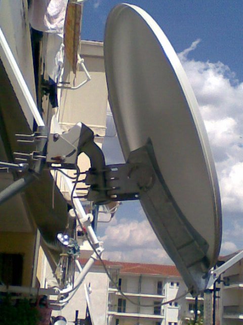

  • about longitude and latitude i think chris is a little confused because of me.
    i have the strange (in my personal motor dish, which is still installed in my fathers home from when i was living there)
    i am living in longitude 21 degrees
    i installed the dish, and i tested through my satellite meter. i had the perfect signal from 30W to 75E (my limits when Lmi 75E was available in Greece)
    for a strange reason , when i connected my receiver (first a dm800 and a few years later a vu+uno) , and set longitude/latitude, the motor had about 3-4 degrees deviation (maybe enigma2 fault, maybe wrong motor calibration?) . i tried to adjust whole the motor/dish 3 degrees, but i was loosing too much from the midle to the limits...
    the solution was to insert fake longitude (about 25 degrees) and it was working perfect...
    so i suggested to chris, if he is sure that the dish is adjusted perfect, to try change the values of latitude , and watch what happens
    the dish is still there for anyone who wants to examinate it :cool1:
